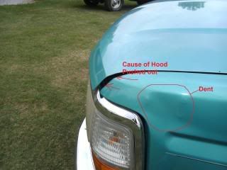

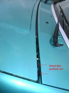

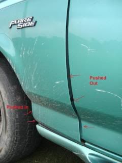

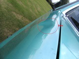

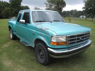

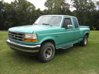

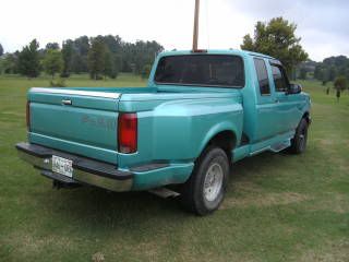

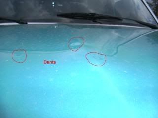

August 29, 2009 at 10:14 pm #15579Here are some pictures and all of the body damage to the car but I’m planning on putting all new panels on the front (both side quarter panels, and hood)
the car has no rust at all
when my mom bought the truck the body was perfect i caused the damage when i went off the road into a 3 ft ditch and the front end flexed and went back in place the frame is fine.I am a real fast learner and i get things real easy just first got to know what to do and how to

http://i58.photobucket.com/albums/g244/guitarplayer3y/SANY0017.jpgAugust 31, 2009 at 12:46 am #15591everything is fine its the hood that is the only thing out of alignment and thats cause off the mounts and that one fender is twisted
and no im going to get rid of that color completely thats why im painting it
im making it metallic blackAugust 31, 2009 at 3:28 am #15596well im replacing all the fenders and hood and hood mounts
the first think though is what grit sand paper do i need to start sanding with and end with before the primerAugust 31, 2009 at 3:53 am #15597if you are replacing all the damaged parts what do you need primer for. if the rest of the truck is in good condition wet sand it with 600, scuff the jambs with a scotch pad. then seal and paint it. if you need to do some minor body repair then check out jimmo’s videos and links
http://www.refinishnetwork.com/uncatagorized/training-courses.htmlbody work can be finished off in 180 grit put you need to feather the surrounding areas before priming
August 31, 2009 at 4:12 am #15598well the paint has some chips in it down to the metal in some places what do i do about that
AnonymousAugust 31, 2009 at 5:12 am #15600Sand them down to the metal, feather the paint, prime, block sand. If you want to cheat you could just fill it with spot putty, not the proper way.
