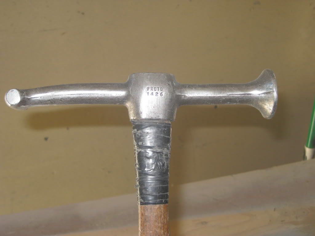

May 18, 2013 at 7:25 pm #43198If you take a 3m 3 inch brown cookie or clean and strip disk and remove the ecoat on the corner it will help the edge fold over easier.Also when you are finished folding the edge over take a da(old knuckle duster sander)in the lock mode and use a crosshatch pattern you can metal finish the edge for a perfect filler free job.I have found the old proto 1426 body hammer to be the best door skin hammer.I also agree with what Mo said 😉 http://i580.photobucket.com/albums/ss241/jaysonm1969/myhoney077.jpg
